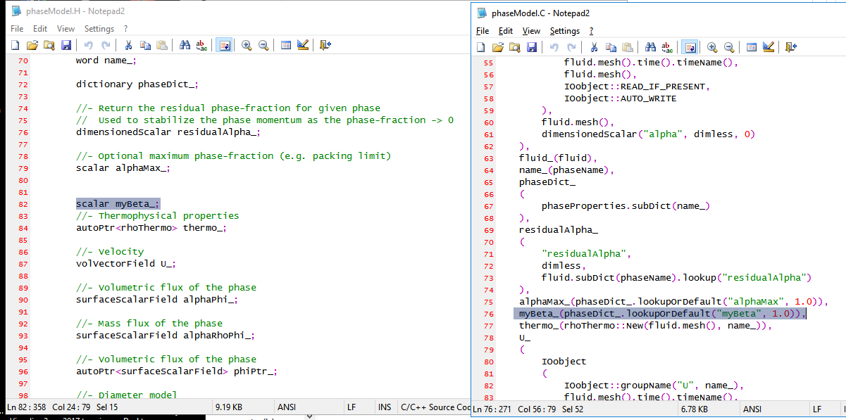

    @kimy yes, declaration in .H file and definition in .C file.
    declaration of function myBeta() in phaseModel.H
    //- Return the maximum phase-fraction (e.g. packing limit)
            scalar alphaMax() const;
            scalar myBeta() const;
    and definition of function myBeta() in phaseModel.C
    Foam::scalar Foam::phaseModel::alphaMax() const
        return alphaMax_;
    Foam::scalar Foam::phaseModel::myBeta() const
        return myBeta_;

    @bestucan But why alphaMax() was originally defined in the phaseModel.H without any error?
                return alphaMax_;
    After I defined only scalar myBeta() in phaseModel.H, the following error occurs:
    In file included from phaseModel/phaseModel.C:26:0:
    phaseModel/phaseModel.H:158:29: error: invalid declarator before 'd'
             tmp<volScalarField> d() const;
    phaseModel/phaseModel.H:162:26: error: non-member function 'const Foam::PhaseCompressibleTurbulenceModel<Foam::phaseModel>& Foam::turbulence()' cannot have cv-qualifier
                 turbulence() const;

    @kimy because the position of this part
                return alphaMax_;
    in phaseModel.H belong to the declaration of class phaseModel.
    so you do have to name alphaMax() as phaseModel::alphaMax()
    as for "Foam::", just for rigorous.
    "declaration in H and define in C" is not something like ban. just a rule free to follow. and it's a good habit.
    you had edit your last post and delete the important part. I've seen it. you lost a ";". and error also said "invalid declarator before 'd'"

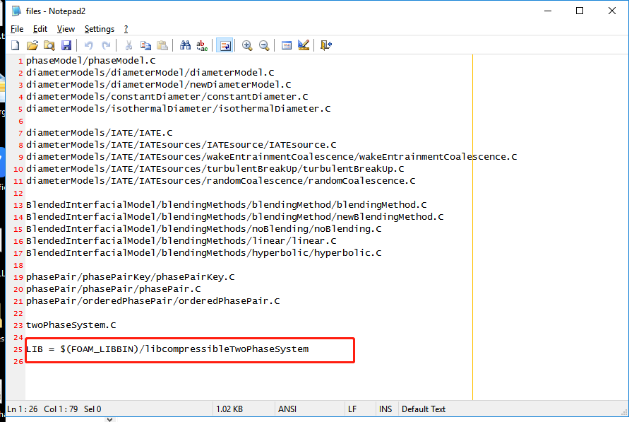

    @bestucan I am a little bit crazy because my files are totally same as yours.......Still error after run. Note that I did not change the default library into user's library (All of them I leave it as defualt "LIB = $(FOAM_LIBBIN)/liblibcompressibleTwoPhaseSystem"
