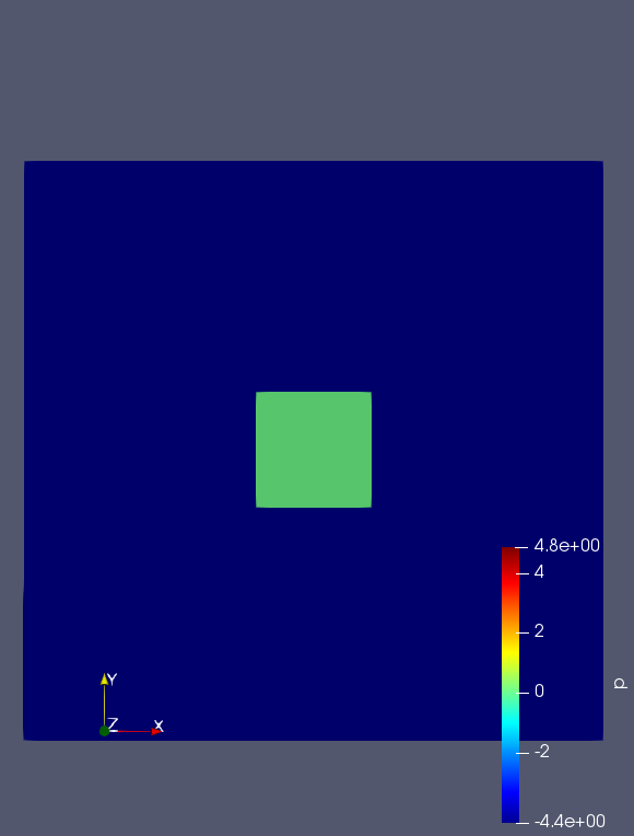

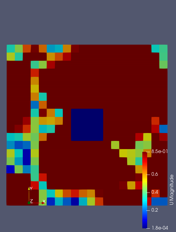

    toposetDict
    actions
        // porousBlockage
            name    porousBlockageCellSet;
            type    cellSet;
            action  new;
            source  boxToCell;
            box     (0.04 0.04 -1) (0.06 0.06 1);
            name    porousBlockage;
            type    cellZoneSet;
            action  new;
            source  setToCellZone;
            set     porousBlockageCellSet;

    modify the matrix, set the value of p and U as 0.

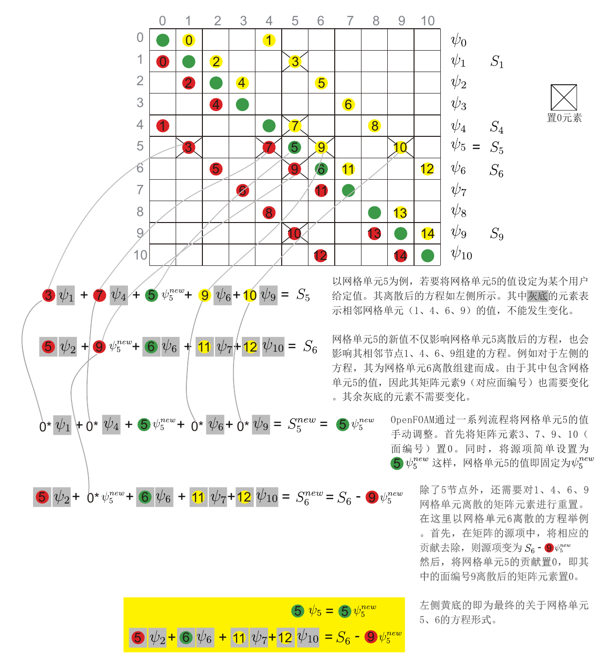

    @马乔 在 OpenFOAM有方法能够使一部分网格不参与计算吗? 中说:
    可以给出一些有关矩阵修改的参考文献吗?目前也需要对一些给定单元赋值(通过周围正常求解网格单元的值进行插值),OpenFoam中的fixedinternalValue边界条件也有类似功能,但不是很理解。

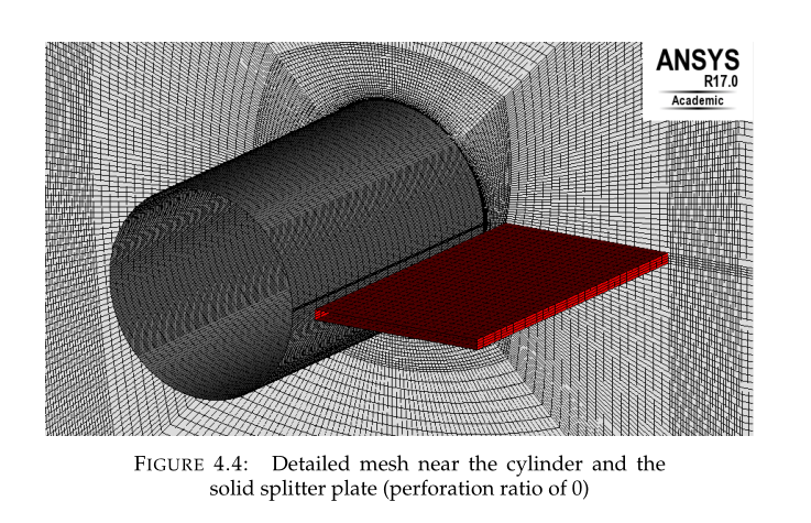

    (Sorry, I don't have chinese input right now)
    I once had the exactly same issue!
    Check my thesis Chapter 6.3 :
    https://scholar.uwindsor.ca/cgi/viewcontent.cgi?article=8585&context=etd
    I wrote a paper in this: https://ascelibrary.org/doi/pdf/10.1061/9780784415153.ch06

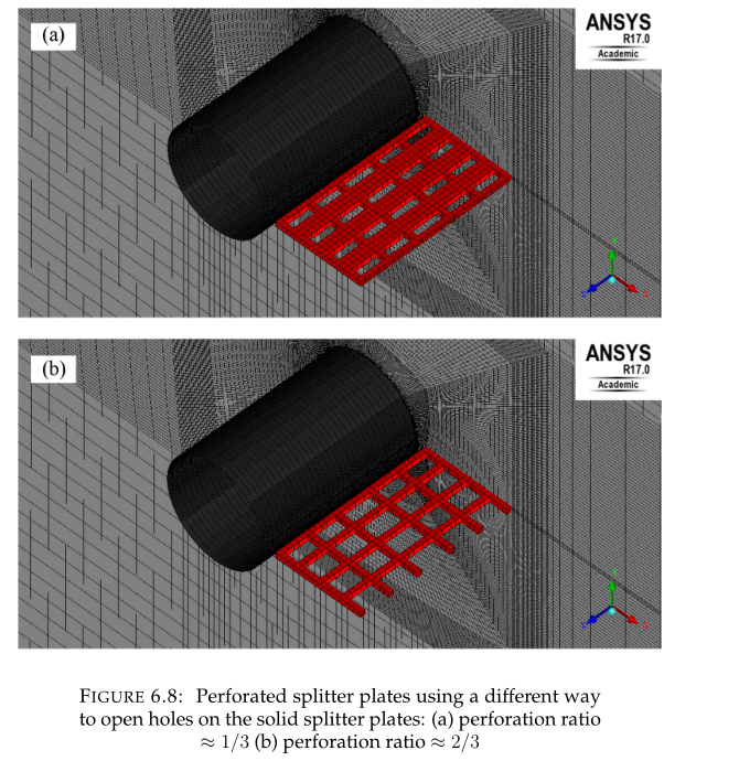

    Figure 2 is the original plate. (Sorry due to copy-right reason, I cannot put it here.)
    In my thesis, I had to open the plate with some holes in ICEM. So, I maual dig out the block out of the computation domain.
    It's really a painful process.
    But it works!
    This is the original plate:
    This is after the "dig":
    Yours in CFD,
    Ran

            fvVectorMatrix UEqn
                fvm::ddt(U)
              + fvm::div(phi, U)
              - fvm::laplacian(nu, U)
            // 固定值
            labelList cells = mesh.cellZones()["null"];
            vectorField value(cells.size(), Zero);
            UEqn.setValues(cells, value);
            if (piso.momentumPredictor())
                solve(UEqn == -fvc::grad(p));
    可以通过设定一个null区域,然后对区域的网格点强行赋值,但就像我之前说的,总觉得边界处需要处理。也就像 @cccrrryyy 说的,变成了浸没边界法。这个代码只是大体上是个思路,需要更深的研究。可以看看fvOptions里面一些源项的处理,都是操纵矩阵的,比如fixedTempresure,meanVelocityForce等,
