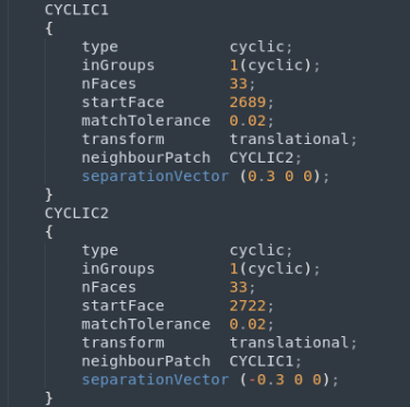

    @yzxwh 增加translational关键字试一试,由于算例没有Allrun,没试算对不对。
    patches
            name CYCLIC1;
            patchInfo
                type            cyclic;
                neighbourPatch  CYCLIC2;
                matchTolerance  0.02;
                transform translational;
                separationVector (0.3 0 0);
            constructFrom  patches;
            patches (left);   // 源面
            // set f0;
            name CYCLIC2;
            patchInfo
                type            cyclic;
                neighbourPatch  CYCLIC1;
                separationVector (-0.3 0 0);
            patches (right);
            // set f0;
    转换后boundary文件:

    @coolhhh 这是of2206写法。如果是org版本,记得of8关键字和平移向量写法记得有点不同,类似与下面,平移向量的值与of2206的值互为相反数
            transformType   translational;
            separation      (0 -0.3 0);
