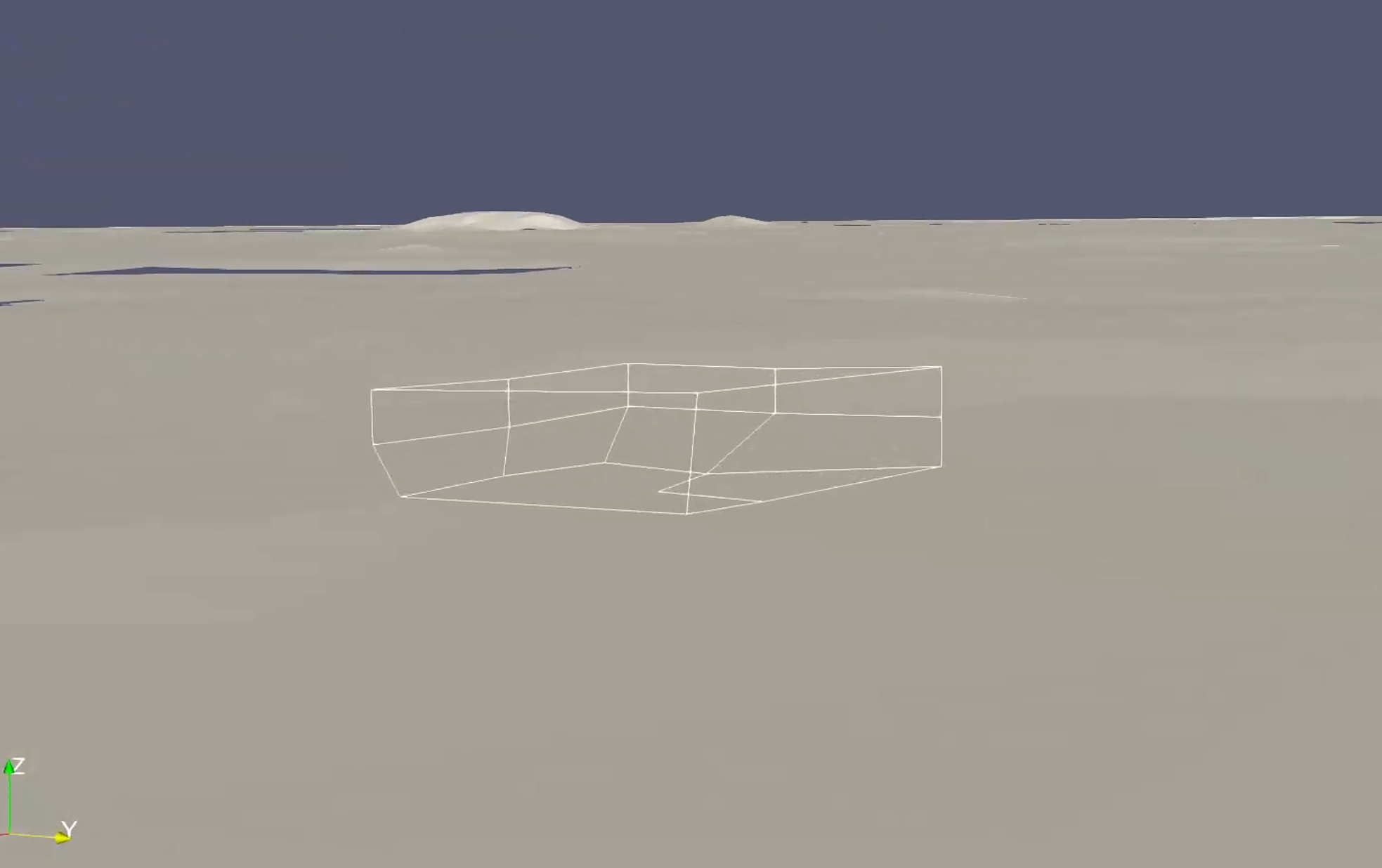

  3. 关于hexRef8 : Dumping cell as obj to ".../cell_813430.obj"的问题

    求大佬看看!

    hexRef8 : Dumping cell as obj to "/mnt/g/City4CFD/City4CFD/examples/TUDCampus/c4c_tst_20240924/cell_813430.obj"
    --> FOAM FATAL ERROR: (openfoam-2312)
    cell 813430 of level 2 uses more than 8 points of equal or lower level
    Points so far:8(467622 506063 542474 660192 812094 865708 953356 1395965)
        From Foam::labelListList Foam::hexRef8::setRefinement(const labelList&, Foam::polyTopoChange&)
        in file polyTopoChange/polyTopoChange/hexRef8/hexRef8.C at line 3604.
    FOAM aborting

    通过报错信息生成了个obj文件,求问这个是个啥,为什么会生成
    https://www.cfd-online.com/Forums/openfoam-meshing/133850-snappyhexmesh-problems.html
