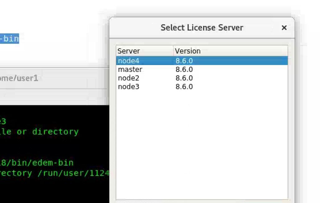

    /opt/SentinelLM/bin/lserv
    /opt/SentinelLM/bin/lslic -f /opt/SentinelLM/bin/EDEM_SSQ.lic

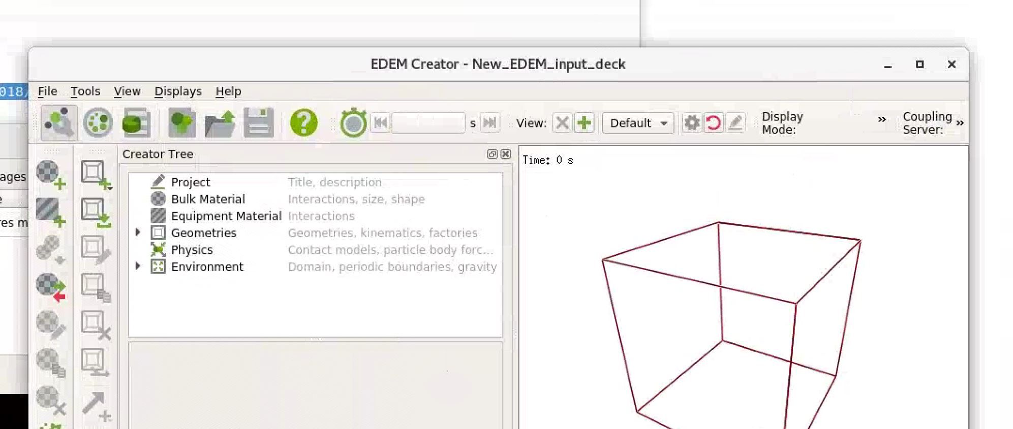

    /opt/DEMSolutions/EDEM_2018/bin/edem-bin
    如果提示xcb的问题,注意一下libudev.so.0这个库能不能找到
