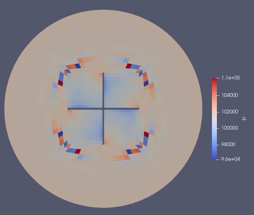

  3. 搅拌桨叶附近压力异常
搅拌桨叶附近压力异常

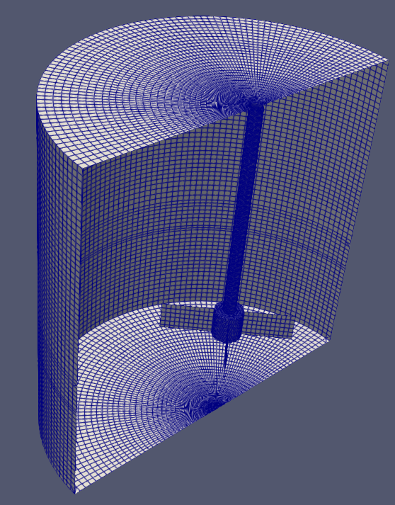

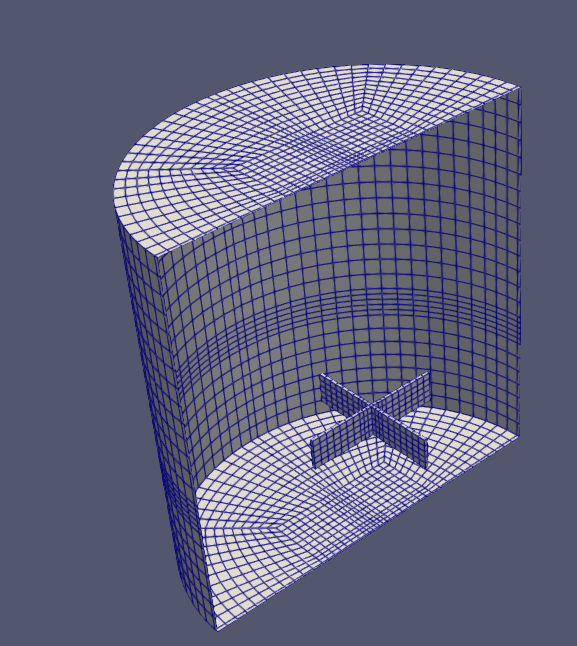

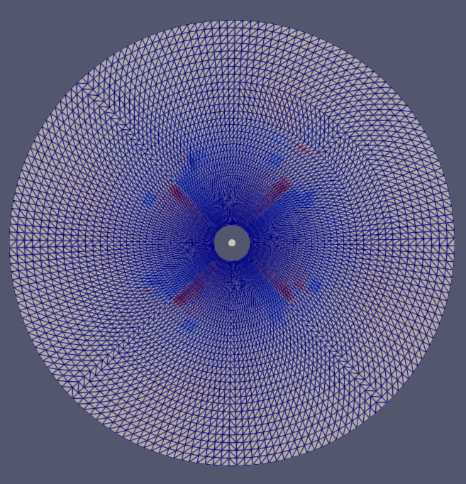

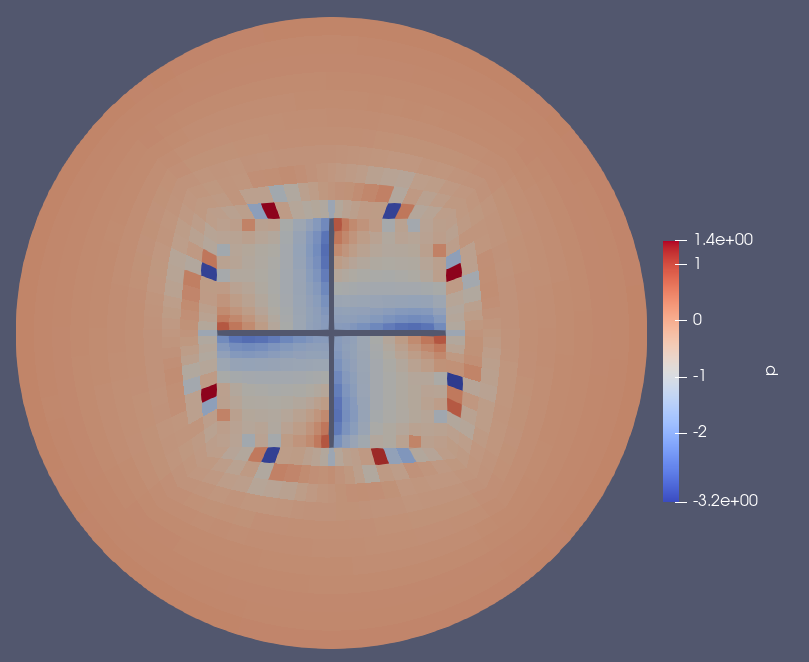

    @tidedrinker 感谢你的认真解答,首先网格粗细问题的话,我本来是在精细网格下计算多相流时发现的这个问题,然后用粗网格再次验证了下,最开始的网格如下:9a8f2d8b-93f8-427a-9ae0-b782917fa167-image.png
    另外MRF区域使用topoSet进行设置,区域直径约为1.2倍的桨叶直径和高度。
    兄弟你最后一句话是啥,没写完。

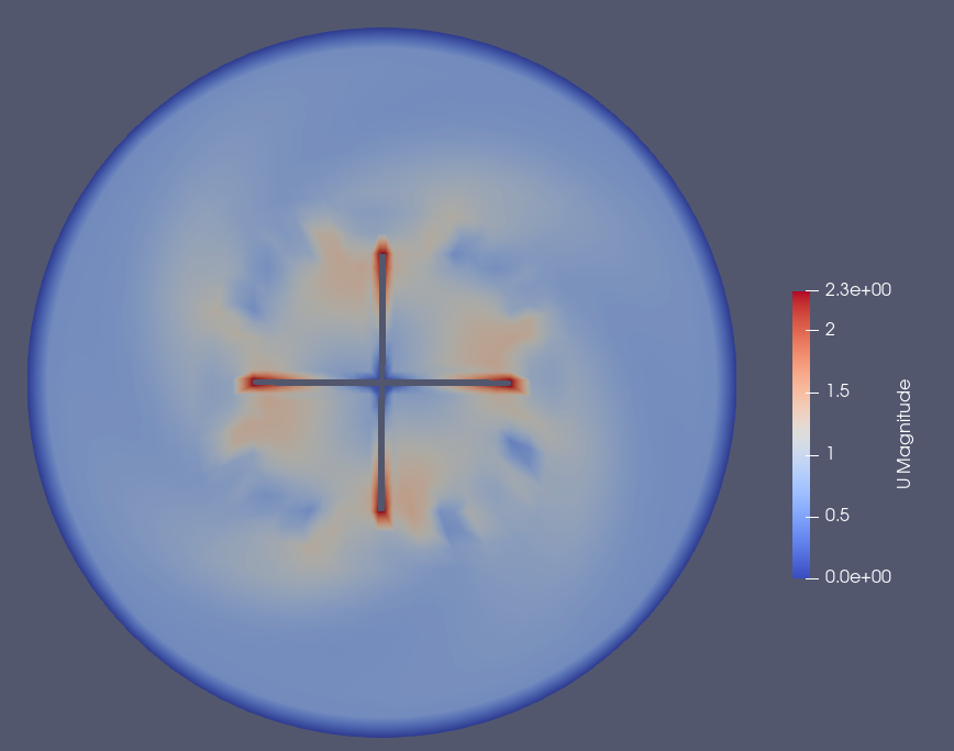

    把你的云图,不要显示插值场,显示间断场看一下。

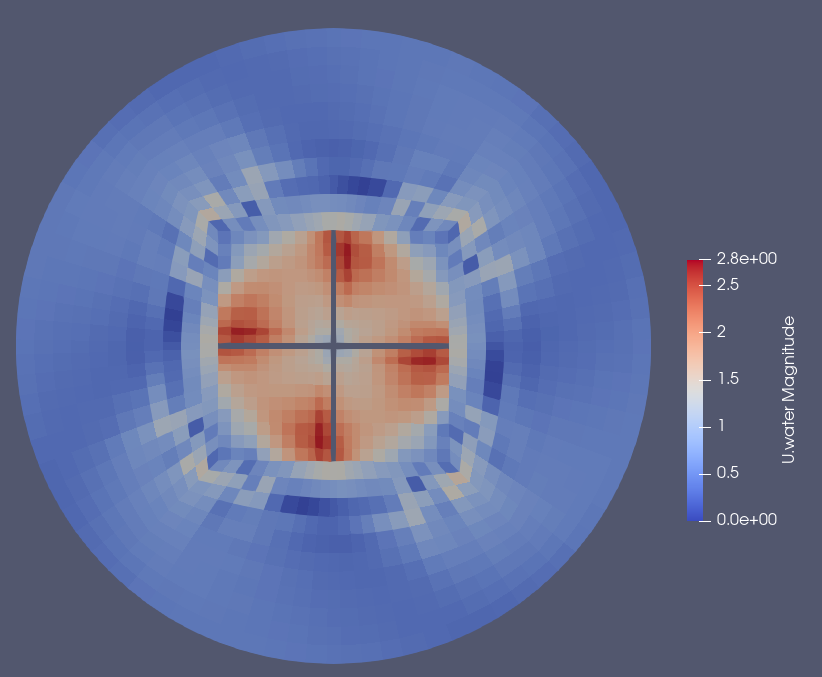

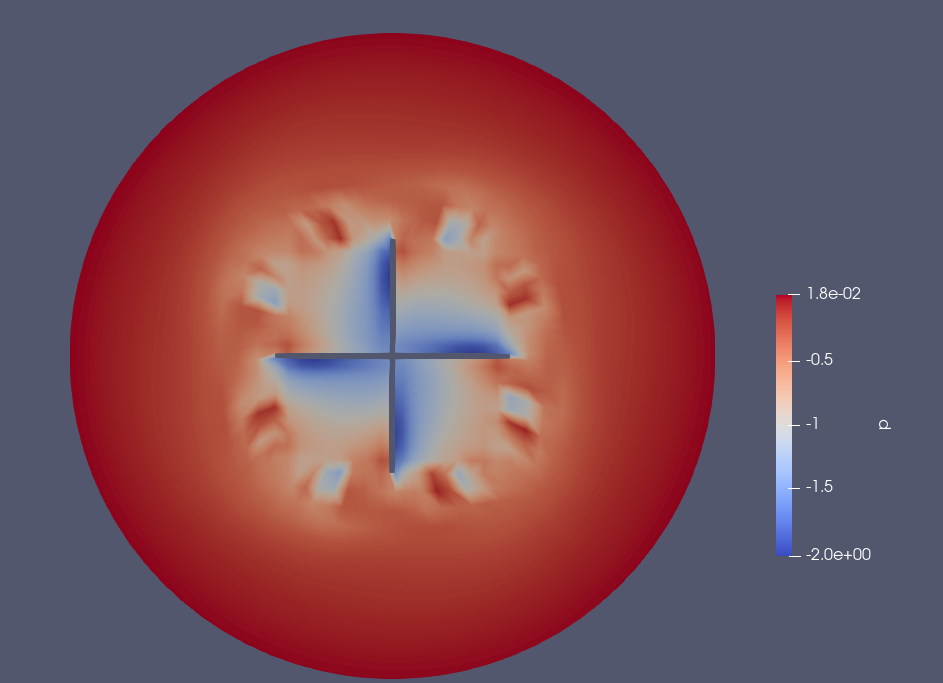

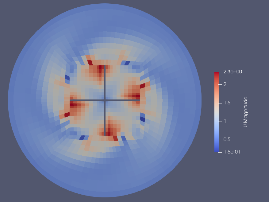

    @李东岳 东岳老师,这是用multiphaseEulerFoam算液固两相的压力场和速度场:09cac503-d901-4395-a2f0-c9540a28ac33-image.png
    好像没转起来,MRF转的方向对么

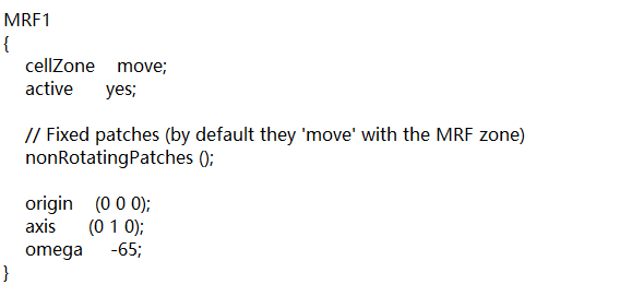

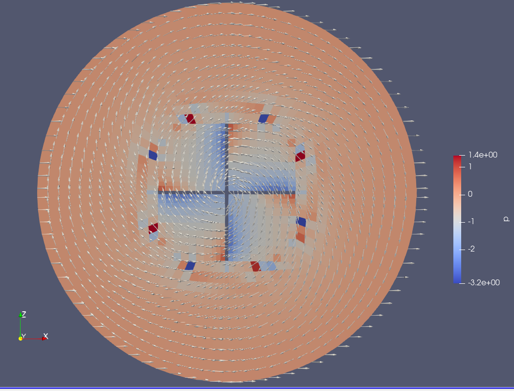

    @李东岳 老师,MRF区域应该没啥问题,沿Y轴旋转,650rmp。8e9a8d80-2f54-4d1b-b6f3-37f0d071d10d-image.png

    1.首先感觉你的网格正交性不是太好,请查验
    2.请告知你的网格物理尺寸
    3.是否做了网格无关性呢
    4.感觉大概率是网格数不足,及网格质量不好的原因
    5.请参考这篇文章 https://journals.sagepub.com/doi/pdf/10.1260/1757-482X.3.1.13
    6.条件许可的话网格建议上千万,湍流方法建议用LES
    7.所有壁面处建议都加密并注意查看y+

    @知行 感谢耐心解答!首先网格的质量如下:
    Mesh stats
        points:           182724
        faces:            532288
        internal faces:   516536
        cells:            174804
        faces per cell:   6
        boundary patches: 3
        point zones:      0
        face zones:       1
        cell zones:       3
        hexahedra:     174804
        prisms:        0
        wedges:        0
        pyramids:      0
        tet wedges:    0
        tetrahedra:    0
        polyhedra:     0
    Checking topology...
        Boundary definition OK.
        Cell to face addressing OK.
        Point usage OK.
        Upper triangular ordering OK.
        Face vertices OK.
        Number of regions: 1 (OK).
        walls               10840    10915    ok (non-closed singly connected)
        impeller1           1324     1326     ok (closed singly connected)
        outlet              3588     3663     ok (non-closed singly connected)
    Checking geometry...
        Overall domain bounding box (-0.109995 -1.11019e-16 -0.109997) (0.109995 0.22 0.109997)
        Mesh has 3 geometric (non-empty/wedge) directions (1 1 1)
        Mesh has 3 solution (non-empty) directions (1 1 1)
        Boundary openness (5.83486e-16 -2.30396e-16 4.46812e-17) OK.
        Max cell openness = 3.29007e-16 OK.
        Max aspect ratio = 5.02531 OK.
        Minimum face area = 1e-06. Maximum face area = 2.73916e-05.  Face area magnitudes OK.
        Min volume = 4.64288e-09. Max volume = 1.25165e-07.  Total volume = 0.0083523.  Cell volumes OK.
        Mesh non-orthogonality Max: 39.7405 average: 7.14766
        Non-orthogonality check OK.
        Face pyramids OK.
        Max skewness = 0.506949 OK.
    Mesh OK.
    End
    最大非正交性为39,平均为7,正交性还不错。
    其次,几何是一个直径和高都是22cm的釜,桨叶直径8cm。
    关于网格数量的话,由于目前还在案例调试阶段,所以先用17w的网格算起来比较快,五六十万的网格我也算过,也会出现这种现象。LES的计算代价有点大,所以还是想考虑RANS。
    最后,在所有壁面处我使用了湍流模型kEpsilon的壁面函数,所以是不是对壁面处的网格厚度依赖性不是很大?我尝试把壁面加密一下试试。谢谢!

    @青山 客气,都是几点非常微小的建议哈。
    这篇文章可能和你的算例接近,doi:10.1017/flo.2022.27
    你的网格量感觉不是太容易出较为理想的效果,不连续的地方正是网格正交性不好的地方。你这个网格,即使加密到1000万,正交性不好的地方仍然会出现奇观的点(因为我算过),建议你用CFX等其他工具画网格。浅见。
    收敛收敛

    @青山 壁面和搅拌浆区域必须加密

    @知行 ok,我的网格都是ICEM画的,我加密试试,谢谢
