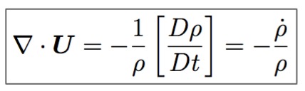

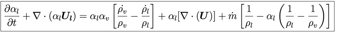

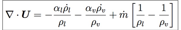

    zwl
    请问为什么会有两个质量源项和两个体积源项?
    yuan_neu
    Q1 Q2
    consider the difference of compressible and incompressible flow, which means that rho_l and rho_v a variable or not,
    it would result in the change in the equations

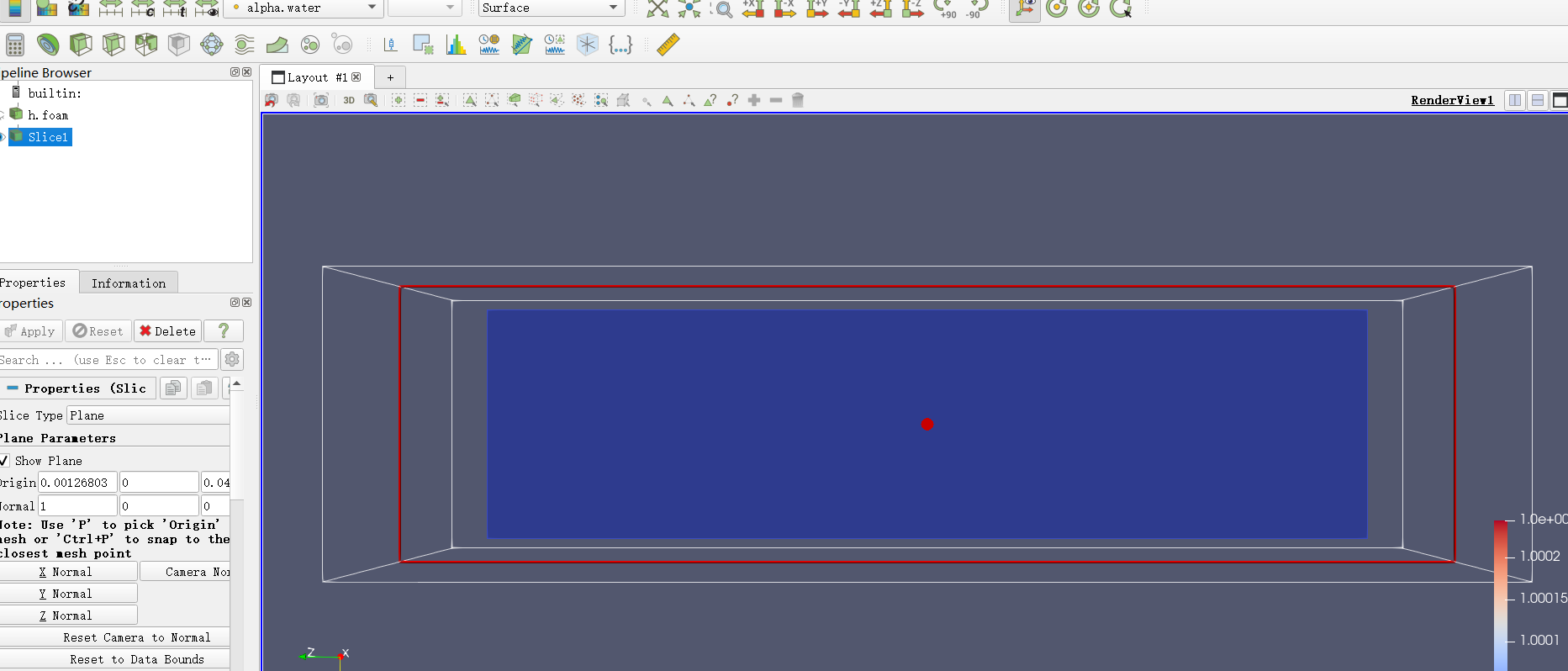

    interPhaseChangeFoam这个案例如何运行,我是先用blockMesh划分网格,然后interPhaseChangeFoam求解器求解,但是结果好像不对
    Leeck
    屏幕截图 2021-06-05 161820.png openfoam自带案例interPhaseChangeFoam求解器下的cavitatingBullet,该图为我跑完0.05s后的水相分布,和0s时没啥变化,请问我哪里错了吗?
