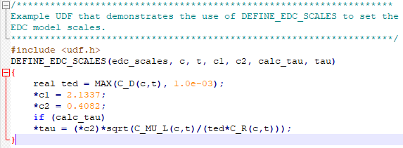

    Fluent中加载编译后的udf时,出现如下报错:
    DESKTOP-6CP1L1E: Opening library "D:\P.Marge et al\ukomega\Frolov4.edc.2016\libudf"...
    Error at host: Error code: 126
    Error: Error code: 126\n
    Error Object: #f
    我尝试了删除libudf文件夹,再重新编译,但问题并未得到解决。
