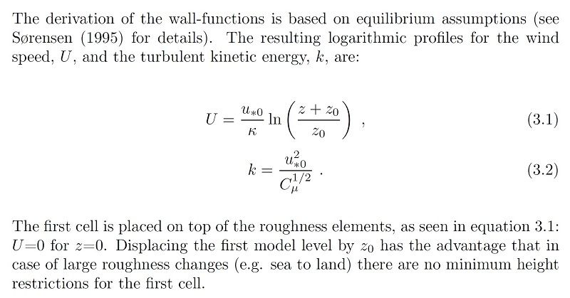

    y+ 的理解不复杂,看code需要一点点的耐心就可以。我给你贴一下yPlusLES。
     if (isA<wallFvPatch>(currPatch))
                    yPlus.boundaryField()[patchi] =
                        d[patchi]
                       *sqrt
                            nuEff.boundaryField()[patchi]
                           *mag(U.boundaryField()[patchi].snGrad())
                       /nuLam.boundaryField()[patchi];
                    const scalarField& Yp = yPlus.boundaryField()[patchi];
                    Info<< "Patch " << patchi
                        << " named " << currPatch.name()
                        << " y+ : min: " << gMin(Yp) << " max: " << gMax(Yp)
                        << " average: " << gAverage(Yp) << nl << endl;
    ![公式](349ba7f5-68a8-4581-94cb-e665d7b9d7b3-image.png 1)
    ![公式2](9660629f-e67b-49c6-b99d-b4832451b5bb-image.png 2)
    ![替代文字](f2cc961e-d7cc-408e-af53-4fe7bb4cf229-image.png 3)
    我写的,你可以输出来看看每一个量的大小

    近壁面第一层网格的话 ,d= 0.5* 第一个cell的长度. du/dy = (u_infty - 0)/ (d-0)
    nuefff = nu (层流 laminar) + nut(wall 上 nut =0 或者是你给的壁面模型的值)
    我给的nut在壁面上就是0.
