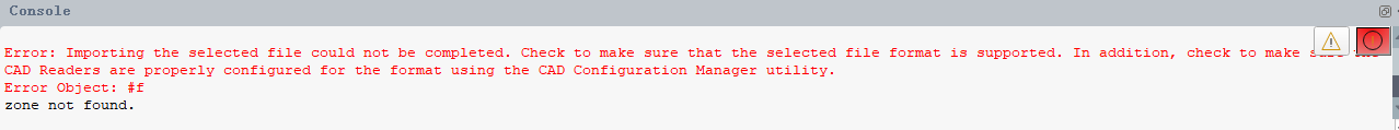

    fluent meshing 无法导入几何,提示错误如下:
    Error: Importing the selected file could not be completed. Check to make sure that the selected file format is supported. In addition, check to make sure the CAD Readers are properly configured for the format using the CAD Configuration Manager utility.
    文件格式不支持或者画几何文件的软件没有配置好接口什么的

    @bestucan 在别人电脑上是正常的 ,很奇怪,我最后重装电脑解决了
