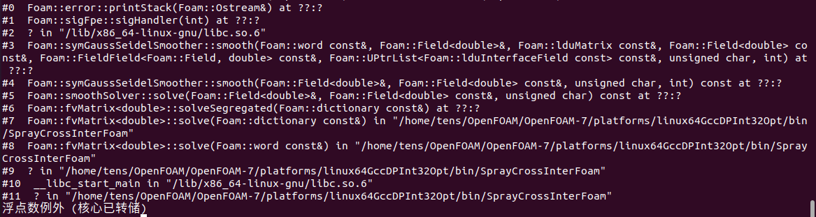

    在compressibleInterFoam中添加组分方程,组分方程如下:
    tmp<fv::convectionScheme<scalar>> mvConvection
        fv::convectionScheme<scalar>::New
            mesh,
            fields,
            alpharho2Phi,
            mesh.divScheme("div(phi,Yi)")
        combustion->correct();
        volScalarField Yt(0.0*Y[0]);
        alpharho2 = alpha2*rho2;
        alpharho2Phi = fvc::interpolate(alpharho2)*phi;
        volScalarField alphamuEff("alphamuEff",alpha2*turbulence.muEff());
        forAll(Y, i)
            if (i != inertIndex && composition.active(i))
                volScalarField& Yi = Y[i];
                fvScalarMatrix YEqn
                    fvm::ddt(alpharho2, Yi)
                  + mvConvection->fvmDiv(alpharho2Phi, Yi)
                  - fvm::laplacian(alphamuEff, Yi)
                    parcels.SYi(i, Yi)
                  + combustion->R(Yi)
                  + fvOptions(alpharho2, Yi)
                YEqn.relax();
                fvOptions.constrain(YEqn);
                YEqn.solve("Yi");
                fvOptions.correct(Yi);
                Yi.max(0.0);
                Yt += Yi;
        Y[inertIndex] = scalar(1) - Yt;
        Y[inertIndex].max(0.0);
    从0时刻开始计算没有问题,在某一时刻停掉计算后续算,没过几步就会报错,报错如下,请问各位有什么建议。

    @tens y方程是跟原本求解器偶合在一起的么?

    @李东岳 老师说的耦合具体是指什么呢
    在 中回复了 Tens 最后由 编辑
    @tens 除了添加y方程之外,还做了什么其他的改动么。

    @李东岳 就算仿照sprayfoam进行添加的,createFields.H里还添加了下面部分,twoPhaseMixtureThermo里将RhoThermo改为了rhoReactionThermo,应该就这些。
    rhoReactionThermo& thermo2 = mixture.thermo2();
    basicSpecieMixture& composition = thermo2.composition();
    PtrList<volScalarField>& Y = composition.Y();
    const word inertSpecie(thermo2.lookup("inertSpecie"));
    if (!composition.species().found(inertSpecie))
       FatalIOErrorIn(args.executable().c_str(), thermo2)
           << "Inert specie " << inertSpecie << " not found in available species "
           << composition.species()
           << exit(FatalIOError);
    const label inertIndex(composition.species()[inertSpecie]);
    multivariateSurfaceInterpolationScheme<scalar>::fieldTable fields;
    forAll(Y, i)
       fields.add(Y[i]);
    surfaceScalarField alpharho2
       IOobject
           "alphaRho2Phi",
           runTime.timeName(),
           mesh,
           IOobject::READ_IF_PRESENT,
           IOobject::AUTO_WRITE
       alpha2*rho2
    surfaceScalarField alphaRho2Phi
       IOobject
           "alphaRho2Phi",
           runTime.timeName(),
           mesh,
       fvc::interpolate(alpha2*rho2)*phi
    F 1 条回复 最后回复
