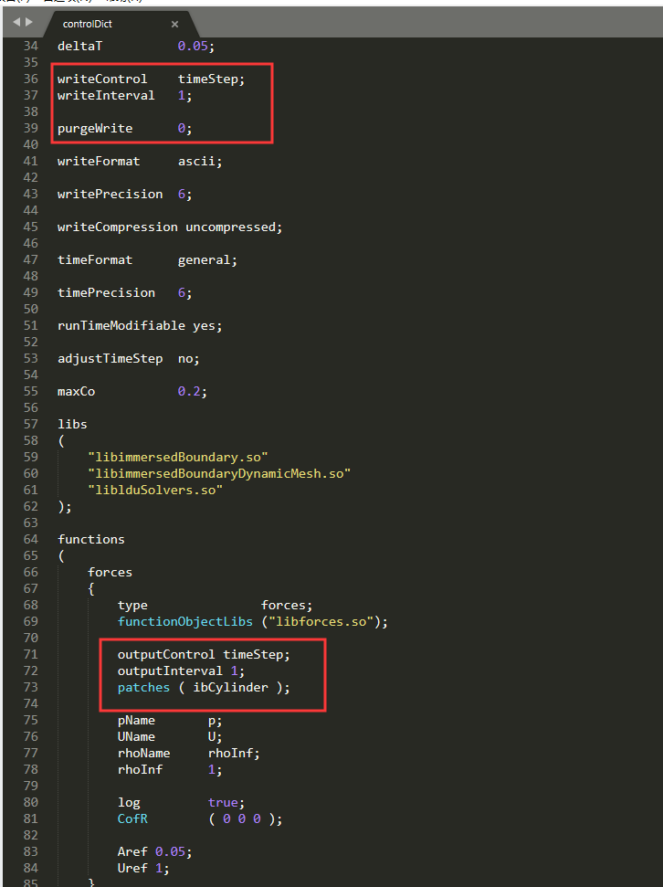

    @五好青年 我看了下 在extended的controldict里面有两个interval
    | \\      /  F ield         | foam-extend: Open Source CFD                    |
    |  \\    /   O peration     | Version:     4.0                                |
    |   \\  /    A nd           | Web:         http://www.foam-extend.org         |
    FoamFile
        version     2.0;
        format      ascii;
        class       dictionary;
        object      controlDict;
    application icoDyMFoam;
    startFrom       startTime;
    startTime       0;
    stopAt          endTime;
    endTime         5;
    deltaT          0.01;
    writeControl    runTime;
    writeInterval   0.2;
    // writeControl    timeStep;
    // writeInterval   1;
    purgeWrite      0;
    writeFormat     ascii;
    writePrecision  6;
    writeCompression compressed;
    timeFormat      general;
    timePrecision   6;
    runTimeModifiable yes;
    adjustTimeStep  no;
    maxCo           0.2;
    libs
        "liblduSolvers.so"
        "libimmersedBoundary.so"
        "libimmersedBoundaryDynamicFvMesh.so"
    functions
        forces
            type               immersedBoundaryForces;
            functionObjectLibs ("libimmersedBoundaryForceFunctionObject.so");
            outputControl timeStep;
            outputInterval 1;
            patches ( ibCylinder );
            pName       p;
            UName       U;
            rhoName     rhoInf;
            rhoInf      1;
            log         true;
            CofR        ( 0 0 0 );
            Aref 0.05;
            Uref 1;
    你把这里屏蔽的换下换成timeStep的
    //writeControl    runTime;
    //writeInterval   0.2;
    /writeControl    timeStep;
    /writeInterval   1;
    下面固体的输出依旧默认1
            outputInterval 1;
