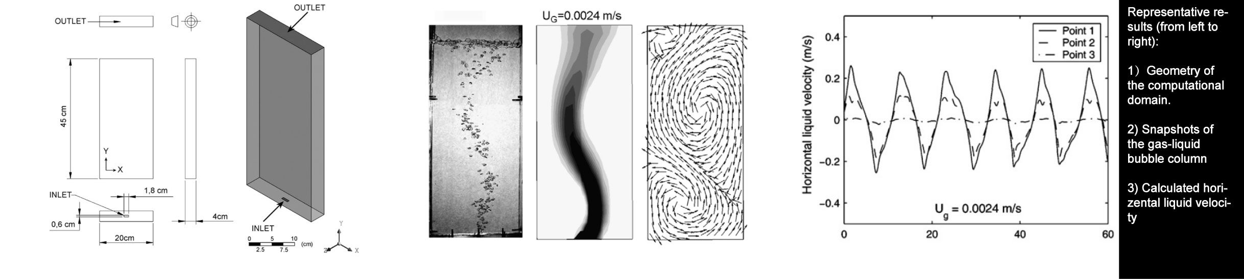

    1. Diaz et al. 2008
    Features: This test case is a laboratory rectangle turbulent bubble column. The gas was injected in the middle of the bottom, which implies the geometry is quite symmetric. Nonetheless, it was also shown that the dynamic periodic liquid circulation can be founded in experiments. Simulations should be able to predict such periodic bubble plume with only the drag model. In addition, the authors also investigated the role of lift force and virtual mass force. The geometry is simple and settings are clear. This test case is suitable for investigate numerical algorithm. It should be noted here that the mean Sauter diameter data was also provided, although not in detail.
    Keywords: Unsteady, Rectangle bubble column, Mean Sauter diameter, Bubble plume,
    Reference: Díaz et al. "Numerical simulation of the gas–liquid flow in a laboratory scale bubble column: influence of bubble size distribution and non-drag forces." Chemical Engineering Journal 139.2 (2008): 363-379.

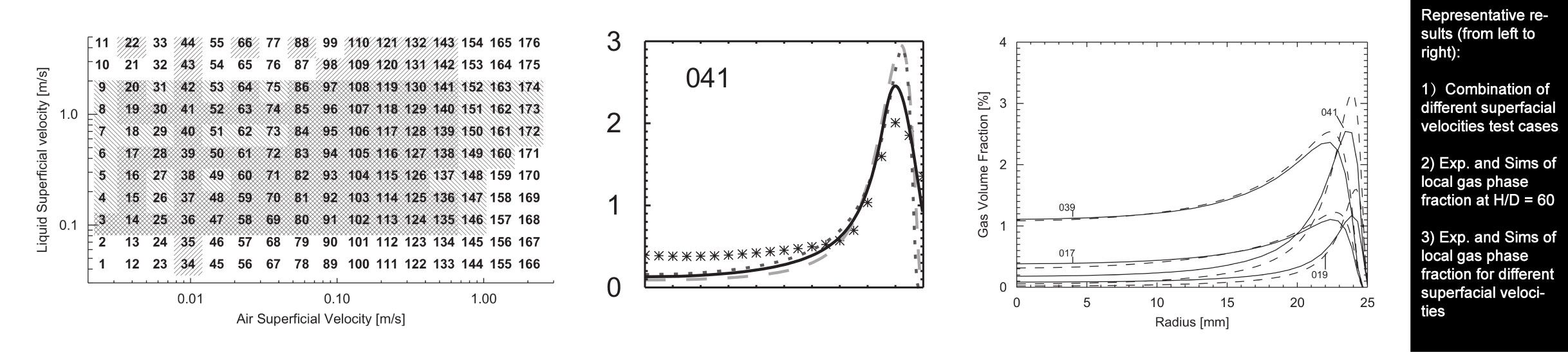

    3. Lucas et al. 2007
    Features: In the work of Lucas et al., bubbly flow in a high aspect ratio column (Column width ~ 0.05 m, Column height ~ 4 m) was investigated. Bubbles and liquid are injected from the bottom. They move upward and at a certain level a fully developed flow pattern is formed. In both experiments and simulations, a quite steady state can be reached at the top of the column. These bubbly flows are operated at relative low phase fraction (~ 3%). The most important feature of the test cases by Lucas et al. is that the momentum exchange interfacial terms play an important role. It was observed in the experiments that the small bubbles tend to move towards to wall. Therefore, a wall peak of the phase fraction should be predicted in simulations. It should be noted here that the lift force, wall lubrication force and turbulent dispersion force should be included.
    Keywords: Steady, Bubbly flow, Lift force, Wall forces
    Reference: Lucas et al., "Use of models for lift, wall and turbulent dispersion forces acting on bubbles for poly-disperse flows." Chemical Engineering Science 62.15 (2007): 4146-4157.

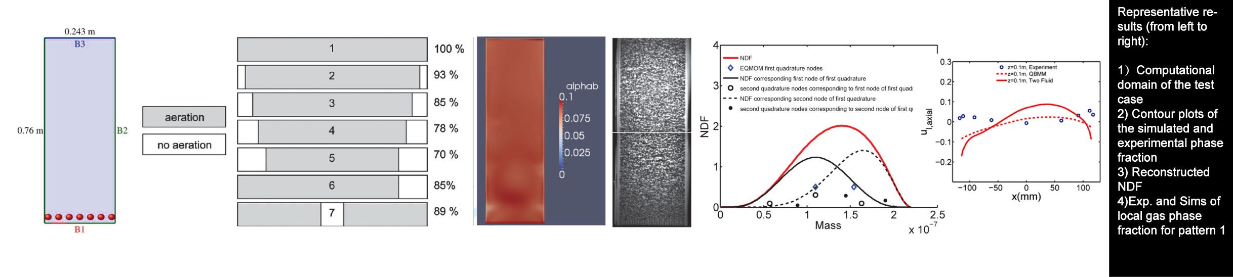

    4. Yuan et al. 2014
    Features: In the work of Yuan et al., an experimantal quasi-2D bubble column was investigated. In the simulations, 2D computational domain was employed. The bubbles are injected from the bottom of the column with different patterns. Overall 5 patterns were studied. Due to the high superficial velocity, simulations are highly transient. In this work, the QBMM was used to predict bubble diameter. However, the experimental diameter data was not reported. The bubble number density function was also reconstructed by EQMOM. It should be noted here that the experimental data reported in Yuan et al. comes from the PhD thesis of Harteveld, see ref (8) in Yuan et al.
    Keywords: Unsteady, Bubble column, 2D simulation
    Reference: Yuan et al., "An extended quadrature‐based mass‐velocity moment model for polydisperse bubbly flows." The Canadian Journal of Chemical Engineering 92.12 (2014): 2053-2066.

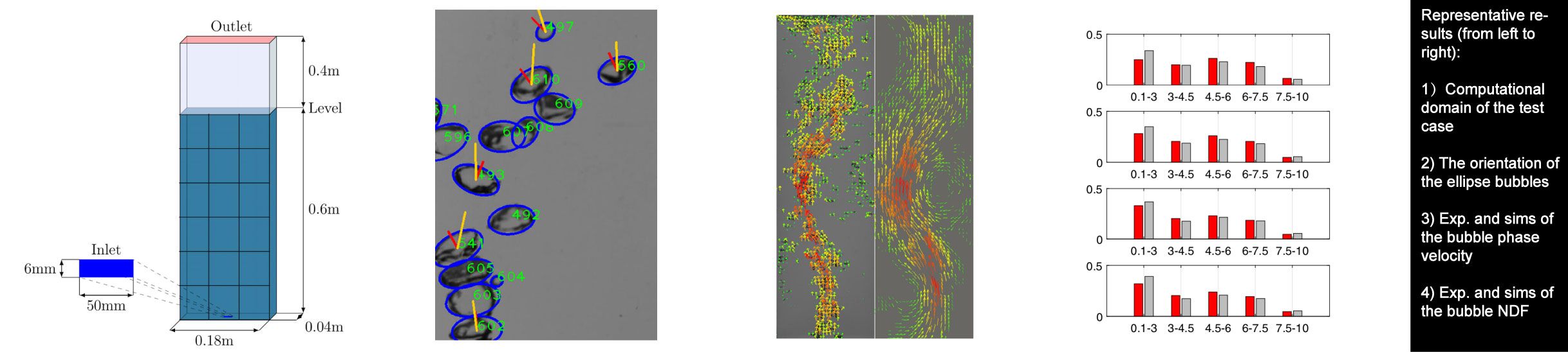

    5. Schafer et al. 2019
    Features: In the work of Schafer et al., a 3D transient bubble column was studied by experiments and simulations. The geometry used in this work is similar with that used by Diaz et al. The unique feature of this work is that the bubble orientation angle data was provided. It can be used as a benchmark test case for multiphase DNS. Besides that, the bubble diameter NDF was also provided both in experiments and simulations. The so-called SQMOM, as a kind of QBMM, was used predict the bubble NDF at different locations and it was compared with experiments.
    Keywords: Unsteady, 3D simulation, NDF reconstruction, SQMOM, Bubble orientation angle
    Reference: Schäfer et al., "Experimental investigation of local bubble properties: Comparison to the sectional quadrature method of moments." AIChE Journal 65.10 (2019): e16694.

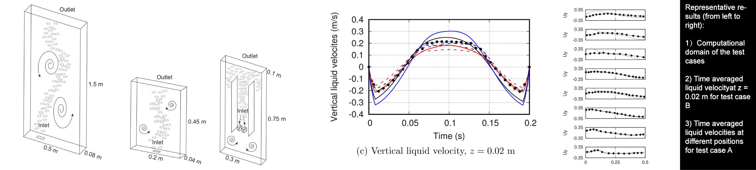

    6. Li et al. 2021
    Features: In the work of Li et al., three 3D transient bubble column was studied to verify the algorithm. One of test case was reported in Diaz et al. The other one consists of a similar partially aerated rectangle bubble column which was investigated experimentally by Becker et al. in 1994. The left one is an airlift bubble column investigated by Mandalahalli et al. Li et al. developed a new algorithm which is much faster than the traditional Eulerian-Eulerian method and used it to simulate three different bubbly flows as mentioned above. Only drag force needs to be included (the last airlift bubble column also needs the turbulent dispersion force). These test cases are suitable to validate new developed algorithms.
    Keywords: Unsteady, 3D simulation, Airlift bubble column, Particlly aerated
    Reference: Li et al. "QEEFoam: A Quasi-Eulerian-Eulerian model for polydisperse turbulent gas-liquid flows. Implementation in OpenFOAM, verification and validation." International Journal of Multiphase Flow 136 (2021): 103544.

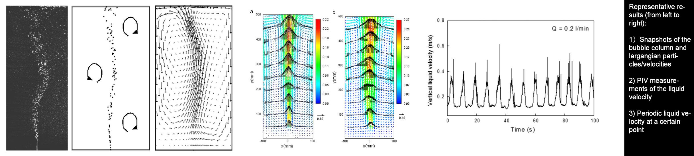

    7. Besbes et al. 2015
    Features: In the work of Besbes et al., a needle sparger rectangular bubble column operated at low flow rates was investigated using PIV measurements and Eulerian-Lagrangian simulations. Time-averaged liquid velocity fields from PIV measurements for different flow rate were provided. Snapshots of PIV and Eulerian-Lagrangian simulation of oscillating bubble plume were also supplied. Due to the small flow rate and the usage of a needle sparger, the diameter of bubbles is very homogeneous. The oscillatory movement of bubble plume, as that observed in Diaz et al., was also formed for slightly large flow rate (Q = 0.2 l/min).
    Keywords: Needle sparger, Eulerian-Largrangian, PIV
    Reference: Besbes et al., "PIV measurements and Eulerian–Lagrangian simulations of the unsteady gas–liquid flow in a needle sparger rectangular bubble column." Chemical Engineering Science 126 (2015): 560-572.

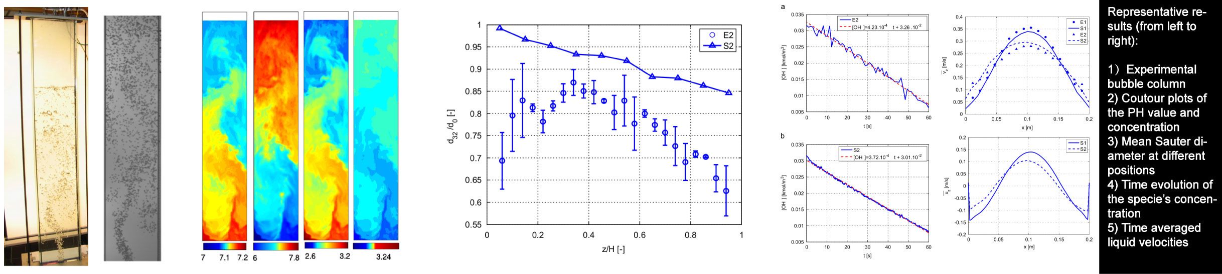

    8. Darmana et al. 2007
    Features: In this work, a rectangle laboratory bubble column was used to study the bubble flow with reactions. A pseudo-2D geometry is chosen to enable visualization of the flow structures by CCD camera and PIV. Lagrangian simulations were also launched. Averaged velocities, bubble plume period, gas holdup and global mean Sauter diameter were also compared with experiments. The species's concentration and Ph value were also provided.
    Keywords: Reaction bubble column, Mass transfer, mean Sauter diameter
    Reference: Darmana et al. "Detailed modelling of hydrodynamics, mass transfer and chemical reactions in a bubble column using a discrete bubble model: Chemisorption of CO2 into NaOH solution, numerical and experimental study." Chemical Engineering Science 62.9 (2007): 2556-2575.

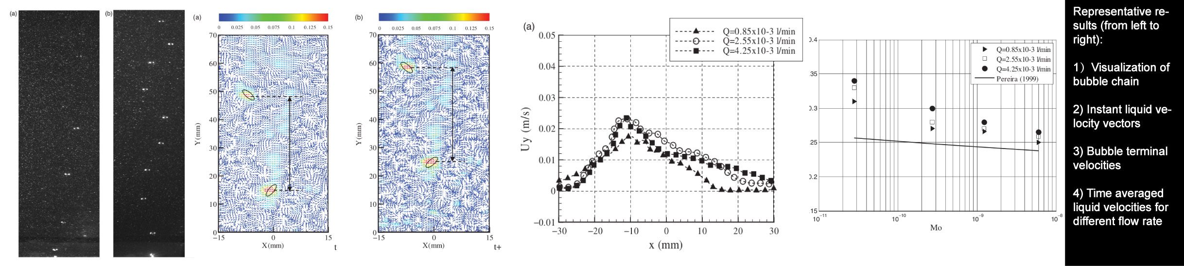

    9. Besbes et al. 2020
    Features: In this work, the authors employ PIV technique to study the liquid phase flow driven by a chain of air bubbles in a rectangular bubble column. The flow rate is very low that each bubble move upward separately by buoyancy force. Not only water, but also the glycerin solution with high viscosity was studied to understand the liquid flow structure. Bubble terminal velocity and shape were also provided.
    Keywords: PIV, Bubble driven flow, High viscosity
    Reference: Besbes et al., "Effect of bubble plume on liquid phase flow structures using PIV." Particulate Science and Technology 38.8 (2020): 963-972.
