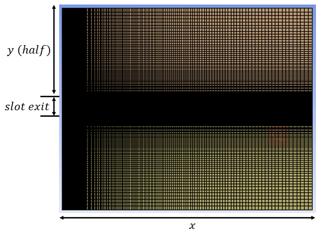

    Speaking to mesh independence study. The idea is simple: refining the
    mesh at the region with high gradient. In reality, it depends on
    researchers to define where are these regions. Even in the simple
    context like flow over a circular cylinder. Different people choose
    different types of the computational domain, different strategies to
    generate the mesh, different parameters to build the block.
    There are something I would investigate:
    1. continue refine the mesh in the "slot exit"
    2. expand the computational domain
    3. expand the "slot exit" region, especially where the shear layers
      are.
    4. use unsteady solver
    5. try LES if you have computational resource

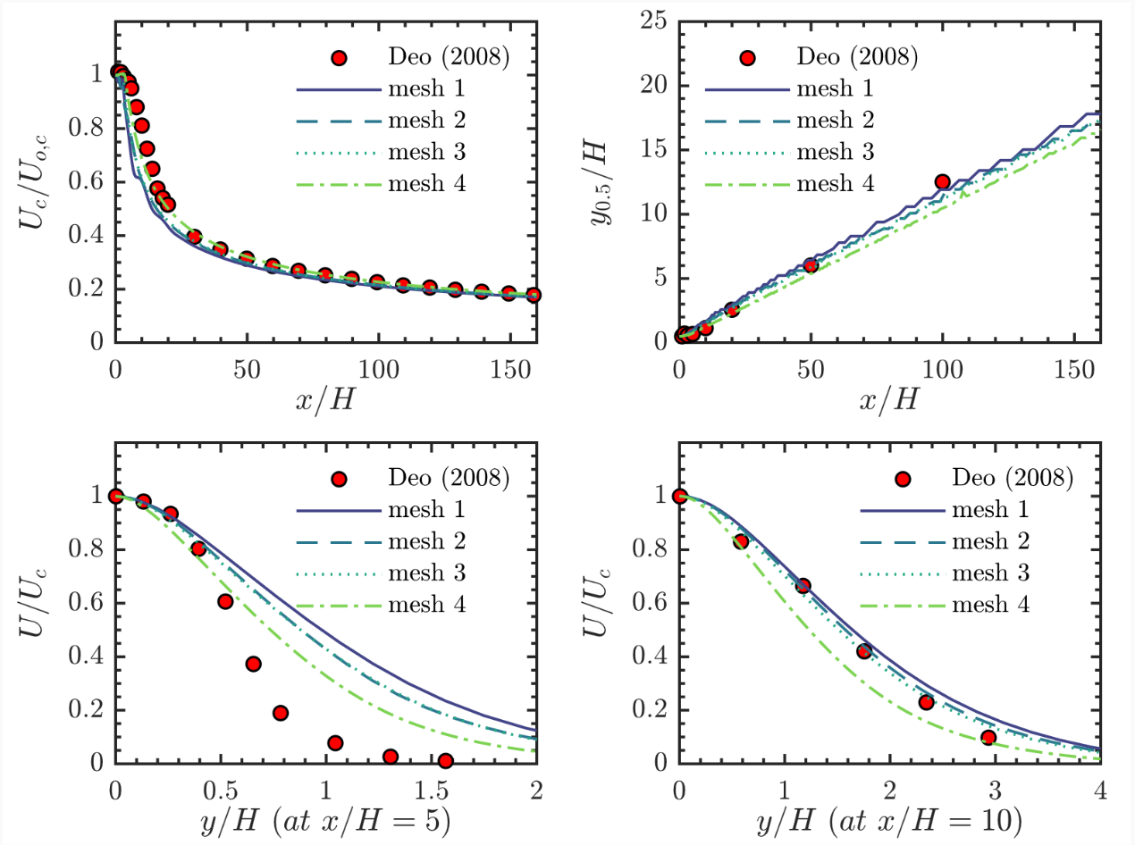

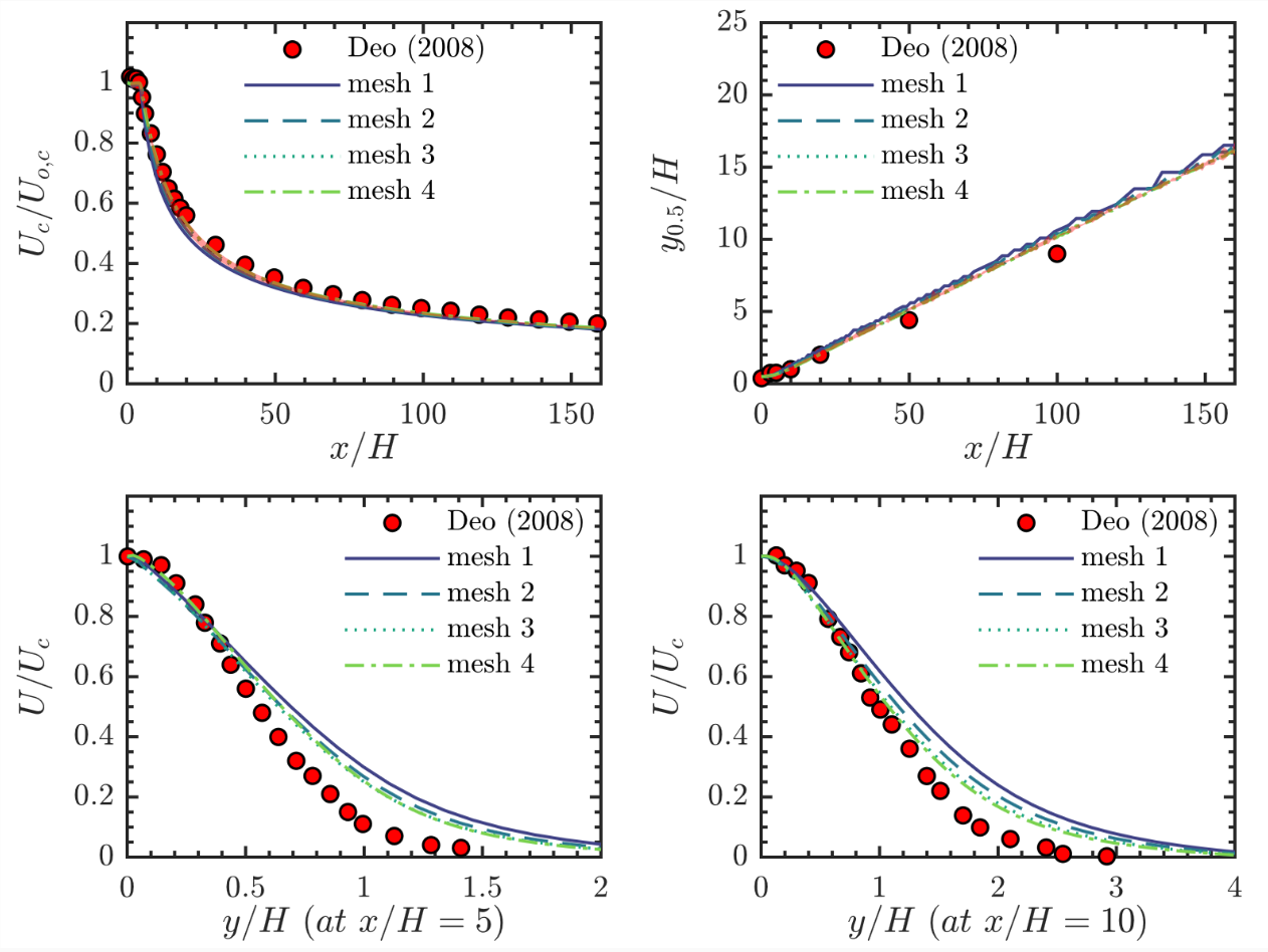

    @random_ran 我还有一个想法。书上都说 standard k-omega 模型是一个高雷诺数模型。我图上测试的是 Re=3000 的结果,无法达到网格无关解。我另外测试了一个 Re=16500 的结果,相同的网格,居然可以达到网格无关解。
