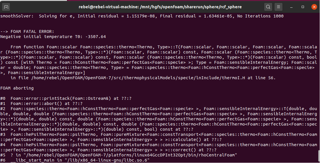

    观察输出的迭代信息,发现,U rhoU rhoE三个值始终残差为0,我以为是不需要设置求解的,尝试在fvsolution中注销掉了,发现计算运行时会报错,说这几个量没有定义。。。定义了好像又不求解。。这是怎么回事呢?
    而且我rcf迭代中,final残差总是比final残差大。。几个量级。。
    并发现,上一步的final并不是下一步的initial残差。这是怎么回事呀?
    初始残差一般都是10的-7量级,怎么迭代后越来越大,但是下一步的初始残差还是e-7。。。:136: 要被虐哭了,大佬帮帮我。
    deltaT = 8.38392e-08
    Mean and max Courant Numbers = 0.010868 0.525071
    Time = 4.93006e-07
    diagonal:  Solving for rho, Initial residual = 0, Final residual = 0, No Iterations 0
    diagonal:  Solving for rhoUx, Initial residual = 0, Final residual = 0, No Iterations 0
    diagonal:  Solving for rhoUy, Initial residual = 0, Final residual = 0, No Iterations 0
    diagonal:  Solving for rhoUz, Initial residual = 0, Final residual = 0, No Iterations 0
    smoothSolver:  Solving for Ux, Initial residual = 6.98094e-07, Final residual = 3.53286e-05, No Iterations 1000
    smoothSolver:  Solving for Uy, Initial residual = 6.01407e-06, Final residual = 5.40888e-05, No Iterations 1000
    smoothSolver:  Solving for Uz, Initial residual = 2.91948e-06, Final residual = 2.84312e-05, No Iterations 1000
    diagonal:  Solving for rhoE, Initial residual = 0, Final residual = 0, No Iterations 0
    smoothSolver:  Solving for e, Initial residual = 7.3214e-08, Final residual = 0.000463259, No Iterations 1000
    ExecutionTime = 48.36 s  ClockTime = 54 s
    siboS 1 条回复 最后回复
  • R 离线
    R 离线
    RebelYoung
    log.zip
    上传一个log文件。。。
    密度初始残差就是0,这正常么:134: 还是有这种类型的计算,只是我孤陋寡闻不知道。
    假设它是不正常的,那么所谓的负温度其实是温度的数值溢出。密度在那一直不动,还有速度去挤它,可不是一挤就爆(一步就发散)。强行挤压,可不温度爆表。
    你的生猛操作类似把涡轮发动机安到汽车上,确实很容易出事:yes:

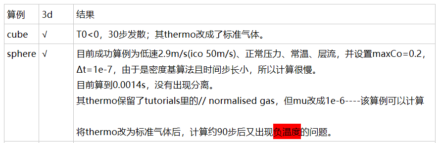

    一开始我算的超过0.3Ma ,很快发散。我怀疑是雷诺数太高的层流问题。。。就把速度改小了,雷诺数在10的3次方量级。

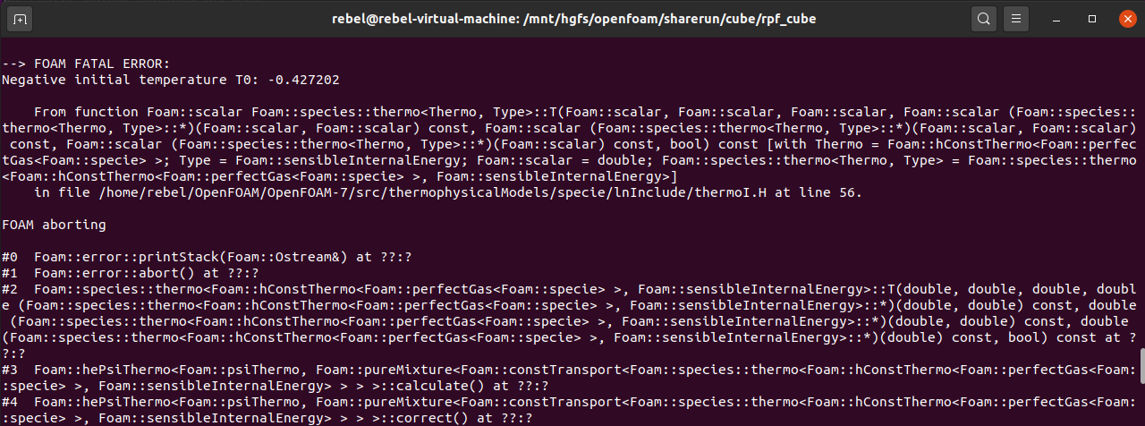

    以上基本描述的都是rhoCentralFoam问题,报错是Negative Initial Temperature,但是全场最小温度并没有负值。。
    这个rcf_sphere_laminar是根据,$FOAM_TUTORIALS/compressible/rhoCentralFoam/obliqueShock改的。是层流计算,/0下设置了p,T,U三个量。

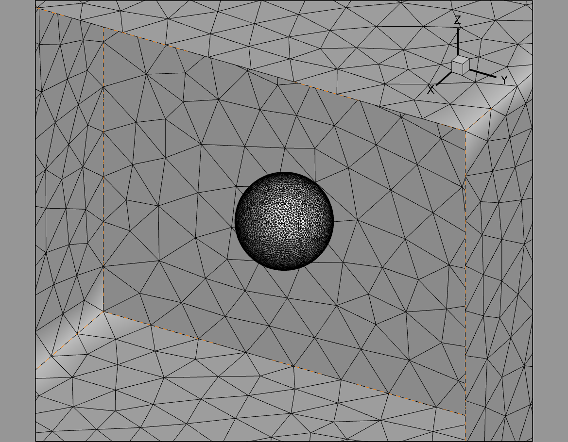

    checkMesh结果:
    Create time
    Create polyMesh for time = 0
    Time = 0
    Mesh stats
        points:           28680
        faces:            309924
        internal faces:   293684
        cells:            150902
        faces per cell:   4
        boundary patches: 4
        point zones:      0
        face zones:       0
        cell zones:       0
        hexahedra:     0
        prisms:        0
        wedges:        0
        pyramids:      0
        tet wedges:    0
        tetrahedra:    150902
        polyhedra:     0
    Checking topology...
        Boundary definition OK.
        Cell to face addressing OK.
        Point usage OK.
        Upper triangular ordering OK.
        Face vertices OK.
        Number of regions: 1 (OK).
        ball                9780     4892     ok (closed singly connected)
        far                 4404     2278     ok (non-closed singly connected)
        inlet               1028     553      ok (non-closed singly connected)
        outlet              1028     553      ok (non-closed singly connected)
    Checking geometry...
        Overall domain bounding box (-0.1 -0.1 -0.1) (0.1 0.1 0.1)
        Mesh has 3 geometric (non-empty/wedge) directions (1 1 1)
        Mesh has 3 solution (non-empty) directions (1 1 1)
        Boundary openness (1.54762e-16 -1.49987e-17 -1.09064e-16) OK.
        Max cell openness = 3.03063e-16 OK.
        Max aspect ratio = 5.29154 OK.
        Minimum face area = 3.38388e-08. Maximum face area = 0.000137468.  Face area magnitudes OK.
        Min volume = 4.46514e-12. Max volume = 4.98913e-07.  Total volume = 0.00799582.  Cell volumes OK.
        Mesh non-orthogonality Max: 58.0988 average: 22.4508
        Non-orthogonality check OK.
        Face pyramids OK.
        Max skewness = 0.67456 OK.
    Mesh OK.
    End

    @bestucan 可是上面minMax监视的全场温度,并没有出现负温度啊?初始值220K,最低也就210.。。
  • R 离线
    R 离线
    RebelYoung
    最新看到的说法是,T估算值或者插值中出现了问题。比如方程解的是h,那么从h=cp(T)T中解出T的估算值,结果是负的。。
    rhoC解的是e,那么e=Cv
    T,cv基本不变,那应该是e出现负值导致T出现负值。。。
    bestucanB 1 条回复 最后回复
    在 中回复了 RebelYoung 最后由 编辑
    @RebelYoung 出现负值不代表计算结果是负的。数值溢出也会成负值。就是大到极限了。
    温度的 min max 最后一步最大值不但跳增,而且离上一个坐标点很远,这很明显有问题啊。一个时间步至少增长了4000K,你的时间步还那么的小。这种增长率很可能是数值溢出了。
