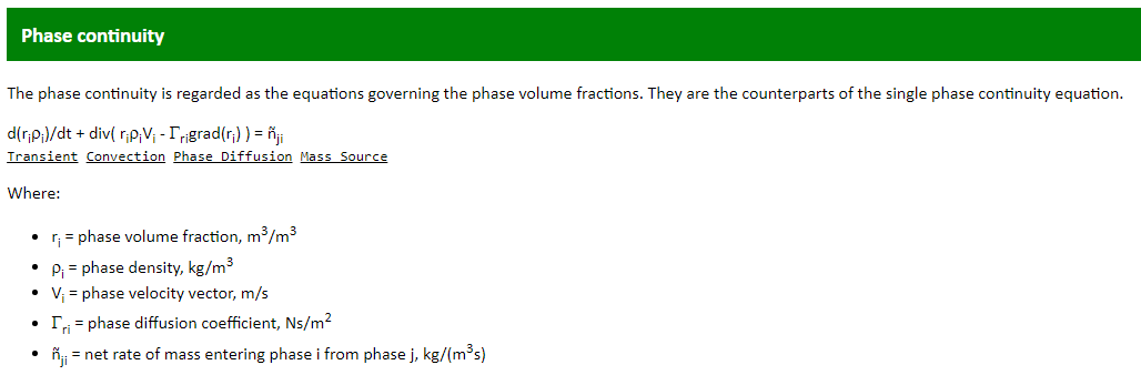

    The equation you posted is not correct. Also, it looks like a constrain condition rather than a transport equation.
    K 1 条回复 最后回复
  • K 离线
    K 离线
    kimy
    在 中回复了 李东岳 最后由 kimy 编辑
    @东岳 Thanks dongyue. I am not sure you are saying which transport equation. However the equation in the image, this is the continuity equation in spalding's IPSA method and we published a lot of paper in which this equation used.
    替代文字
    The first term is a second rank tensor, the second term is a scalar, they are inconsistent.

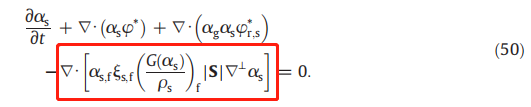

    Dongyue, I understood what you mean but I also found the solution procedure of alpha transport equation in Passalacqua's paper, like following, both of them include the term of fraction gradient.
    @kimy You can have a look at alphaEqn of driftFluxFoam. A similar alpha equation with diffusion term was implemented.

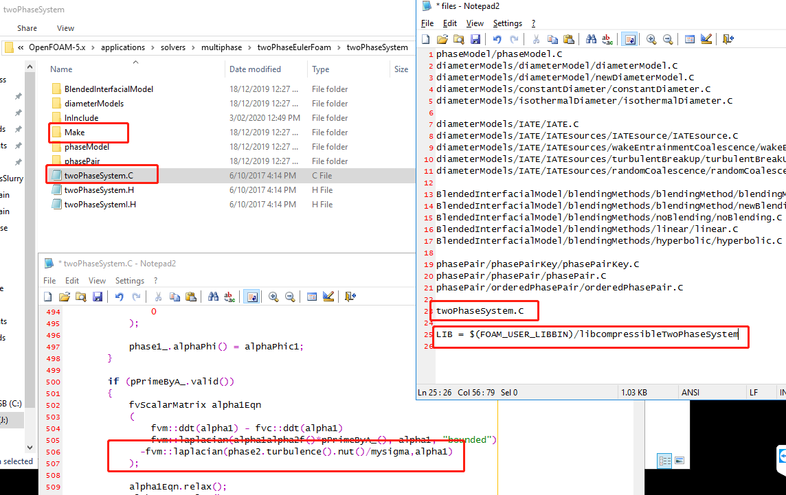

    @东岳 Hi Dongyue, it works. Now I am trying to add it into user's library. I changed the Make/files as following and I include "libmycompressibleTwoPhaseSystem" in system/controDict, but the solver neglect it. I really don't know how to make the solver to call the modified "twophasesystem.C", or I need to change the name of "twophasesystem.C". Do you have any suggestion? Thanks.
    LIB = $(FOAM_USER_LIBBIN)/libmycompressibleTwoPhaseSystem

    @kimy 在 extra term twophasesystem.C 中说:
    Is there any error message, like "cannot find dynamic library..." or "duplicate entry ..." ?
    K 1 条回复 最后回复
  • K 离线
    K 离线
    kimy
    在 中回复了 xpqiu 最后由 编辑
    @xpqiu Thanks for your reply. In fact, There is no error for the compilation and simulation. I don't know how to link the new modified twophasesystem.C to the solver.

    @东岳 Hi, dongyue. I tried many ways to reach my goal, such as create a newtwophasesystem.C (I found this file in the reactingtwophaseeulerfoam, so it should be possible to use a new one) and compile. But I still cannot link the new file to the solver if I put it in the user's library. Do you have any suggestion? Many Thanks.
    the easy way:
    cd \$FOAM_LIBBIN/
    mv libcompressibleTwoPhaseSystem.so libcompressibleTwoPhaseSystem.so.bk
    cp \$FOAM_USER_LIBBIN/libmycompressibleTwoPhaseSystem.so ./libcompressibleTwoPhaseSystem.so
    the best best way:
    add below line in solver's Make/options file
    -L$(FOAM_USER_LIBBIN) \
    -lmycompressibleTwoPhaseSystem
    make sure every line have "\" end except last line.
