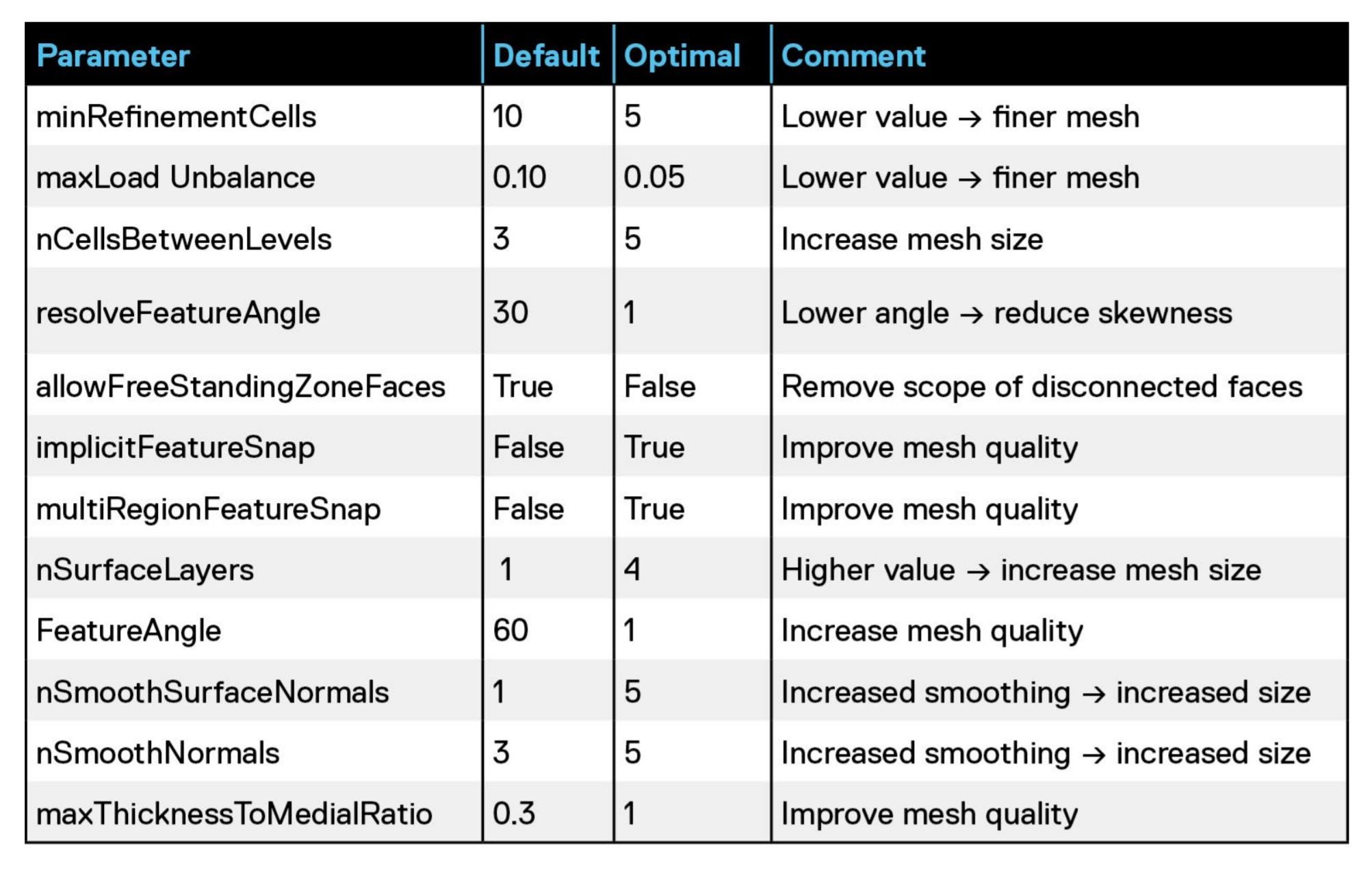

    偶尔看到的,用于大型计算,或许有帮助,比如1500万网格,可以尝试下
    https://www.dellemc.com/content/dam/uwaem/production-design-assets/en-gb/solutions/assets/pdf/uni-of-Cambridge-OpenFOAM-white-paper.pdf
