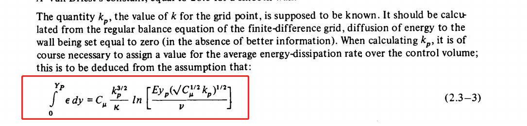

    @东岳 Many thanks. In fact, I understood this procedure. One confusion is that the formula implemented in openfoam is not consistent with that mentioned in the Spalding' paper.WeChat Screenshot_20200504110942.png

    @kimy 在 Code production of k ? 中说:
    Nobody is interested in this issue?
