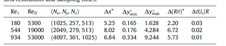

    算dns 雷诺数5300用了1.3亿网格,53000用了12亿网格,
    Direct numerical simulations of fully developed turbulent pipe flows
    for Res = 180, 544 and 934
