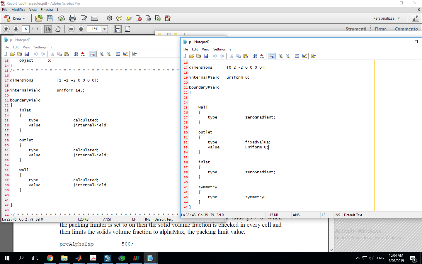

    Why we should give the pressure value in the internalField? Inversly, there is no need to set value for the single phase turbulent flow.
    The left figure is for the two phase flow, the other for the single phase.

    That's internal field, a good approximation is good for convergence. From your depiction I feel you need to learn more about the general CFD knowledge. You can definitely feel that the lacking of CFD theory is holding you back now
